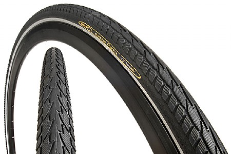

    Just ordered a pair of Continental Contact Extra Lights in 700x42c. If their sizing is consistently narrow, they should measure right around 37mm.

    The 42c Contact Extra Lights measured exactly 37mm on my 23mm rims. Pretty quick on-road, and quite good off-road. Much more predictable than full slicks (I know, "duh").
