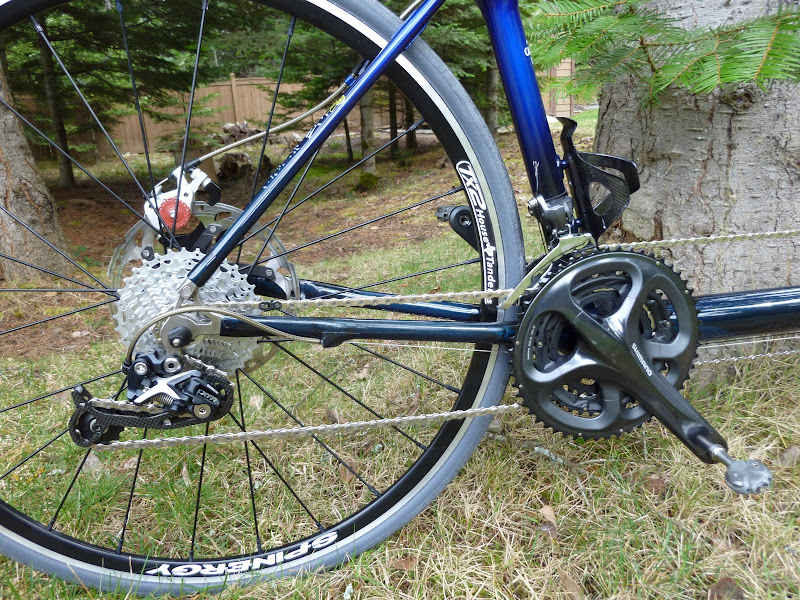

    So far, really big grins on the ride quality of this setup.
    We can't put our finger on whether it is the Calfee frame, the Spinergy wheels, or simply getting rid of the Gatorskin tires used on our previous Santana Team AL (Sovereign w/16 wheels & carbon fork), but we can say the ride is at a whole level above.
    I am still in the process of getting used to the much quicker steering input and cornering results... seems to require a lot less counter steer than the Santana.
    My smallish stoker notices and loves the slightly more spacious cockpit in the back, not to mention the near single bike triple crank Q-factor (at 159mm it is within a couple mm) this is a much better fit to her bio needs. We are progressing very slowly to reintroduce her knees to tandeming again, with 80% single riding and 20% tandem at this stage. Results look very promising and she is very eager to go for more.
    If there is any deficiency to gripe about it is the lack of Flightdeck computer with its nice gear indicator readout. The inline gear indicator I installed (rear only) is working fine as a 10spd gauge.

    Quote Originally Posted by twocicle View Post
    We recently sold our previous tandem and thought we might just build up a lower cost "beater" this time around. Then my stoker happen to stumble upon this new/old stock Calfee frame for sale from Richard Steele of Gold Country Cyclery in (near) Sacramento, CA. and the semi-hi tech/bling game was afoot again.
    The Calfee decal count is definitely a touch on the high side. Not sure if those can be removed without harming the paint finish.
    Attachment 244608
    Here is the intended list of dodads for this new tandem. A few functional items are duplicates (cassettes & brakes) to allow swapping as needed. The initial stem and seatpost are just there to hold the frame in a workstand and hold the fork in place until the final steerer tube cut height is determined.
    Code:
    2007 Calfee Medium/Small Tetra. 145mm rear spacing
    Alpha Q fork paint matched. 700c 44mm rake.
    Cobalt Blue Opaque w/Horizontal fade
    SHIMANO
    Ultegra:
     R601 175mm Captains crankset, w/BB6700 68mm
     R603 170mm Stokers crankset, w/BB6700 68mm 52/39/30 rings
     6700 Brake calipers
     6703 10spd triple (3x10) shifters
     6703 front triple dérailleur
     6700 11-28 cassette
    XTR M972 SGS rear dérailleur
    XT M771 11-34 cassette
    XT RT86 IceTech 203mm 6-bolt Rotor
    OTHER
    Chris King NoThreadset (headset)
    Spinergy Tx2 tandem wheels
    Michelin Pro Race 25mm tires
    Avid BB7 rear disc caliper w/203mm IS adapter
    EBC Disc Brake Pads for Avid Mechanical Gold
    >> deleted >> Gates Carbon belt drive << deleted <<
    Sram PC 1051 P-Lock 10-Speed chain
    Jagwire Racer Road Complete Brake and Derailleur Cable & Housing Kit
    Jagwire Hyper Slick Stainless tandem length cables
    Jagwire in-line cable adjusters
    Cinelli cork handlebar tape
    ISC Helicopter-OG Surface Guard Tape (8 mil Outdoor Grade) as frame saver
    Ritchey WCS EVO Curve 31.8mm 42cm drop bars captain & stoker
    3T ARX 31.8 stems captain 120mm 6 degree & stoker 140mm 17degree
    Deda Zero100 seatposts captain & stoker
    Terry Fly Ti Captain, Terry Butterfly Ti Stoker
    Speedplay Zero pedals captain (stainless) & stoker (Ti)
    Cane Creek stoker pegs
    Arundel Sideloader carbon bottle cages
    Lezyne Road Drive pump
    As you can see from the list above, I made a conscious decision to go alloy on the handlebars, stems and seatposts. The selection is still very lightweight but also durable and a lot more cost effective. Besides, I wanted to avoid problems attaching a seatpost rack on the back, aero bars on the front, and never liked the idea of having a stoker stem clamped on a carbon captain seatpost. With the carbon Calfee frame and AlphaQ fork, plus the Spinergy wheels, the ride should be plenty plush without needing the upper accessories to be carbon as well.
    Starting with getting the Chris King headset installed at the local bike shop, needed a little headtube cleanup first. Don't freak out about the brake pads not lining up... it's a work in progress.
    Update: Full completed build web album (currently without the Gates Belt Drive):
    https://picasaweb.google.com/1095507...eat=directlink

    Quote Originally Posted by akexpress View Post
    It is interesting that you are having the same experience with the tandem clamp from K-edge regarding the derailleurs being to far outboard for the ultegra cranks. I had one of the first tandem clamps from them as I worked with Joe on chain catchers for our Calfee. I previously had Calfee cranks and just replaced them with the new Ultegra cranks and this issue popped up. With my old cranks the clamp worked great because the opposite problem occurred as there was not enough travel outward so shifting to the big ring was not great with any load on it. I think the smaller Q factor has moved the chain lines inward a mm or so on the new Ultegra cranks. I am going back to my old dura ace frt derailleur and conventional clamped K-edge with these cranks. I have a small frame as do our friends and we were both able to use a normal K-edge without problems on the water bottle mount. It mounts above it and uses the long triple arm.
    Right. This K-Edge adapter clamp positioning the FD further outboard by .5cm is a lot. It is not feasible to move the right crank out far enough to make a difference for the FD, and anyway that would be a detriment to the drivetrain-rider alignment.
    Otherwise, I'm considering finding a new FD adapter clamp that positions the FD closer to the seat tube. Competitve Cyclist claims the new Di2 brackets will work with any Shimano derailleur, but those are way over priced at the moment. Maybe an ugly old silver Shimano clamp will be my next try, though not as light weight at least getting the mechanics to function properly is more important.
    I'm going to contact K-Edge and see what they have to say about their clamp.

    After waiting a couple weeks and resending my inquiry to K-Edge, still no response. Fortunately, the FD with their adapter clamp is working fine at the inward limit and without hacking a modification. Just be aware, the K adapter clamp moves the FD .5cm further outward from the seat tube than a FD with a built-in clamp.
    On the latest Calfee feedback, stoker is really happy and riding without any tandem induced knee pain! With the more standard rear 145mm spacing and a single-like Q-Factor, this is the first time since 2003 (and the 160mm spacing/Q-width headache) she has not had any problems. Wow, we took a big chance building up a new ride and it seems to have paid off in dividends. We are finally back on a tandem and riding pain free! Very happy.
    Hydration configuration and how to save 1lb of dead weight:
    In the photos above you can see that we switched from larger & heavier Polar 26oz capacity bottle to the mid-size 22oz Camelback (verfied by measuring cup test). Yes we lose 4oz fluid per bottle, but the bottle itself weighs quite a bit less too.
    The Polar bottles were much taller and a constant source of dripping water and sport drink on the frame. The more compact Camelback bottles have a top that locks & a squirt mechanism takes a bit to get used to while riding, but otherwise seems superior. The smaller Camelback bottle size also solved access issues for the stoker that she has had on both the tandem and her compact single.
    Overall, weight savings from just the empty 4 bottles we switched out is equal to the savings typically found by installing a Gates Carbon Belt setup, and quite a bit more weight saved when factoring in the water load as shown below...
    Polar:
    26oz capacity
    146gm empty
    total full weight each: 852gm
    4x 852gm = 3408gm (3.4kg!) = 7.51lbs for full Polar bottles. Yikes!!
    Camelback:
    22oz capacity
    100gm empty
    total full weight each: 722gm
    4x 722gm = 2888gm (2.9kg) = 6.37lbs <<< still, that weight is near equal to the 2007 Calfee frame!
    Camelback weight savings (4 bottles):
    empty: 184gm (.4lbs)
    full: 520gm (1.15lbs)
    Fun factoids:
    • The 4oz less per bottle in the Camelbacks has not been noticable to us from a hydration point.
    • The time it takes my stoker to use up 2 full 22oz bottles is about the max time she can handle between potty breaks.
    As always, the biggest weight diff is usually body composition. Reviewing photos above will reveal the captain had a lot more than 1lb savings in the 2nd photo taken some 3 months later.
