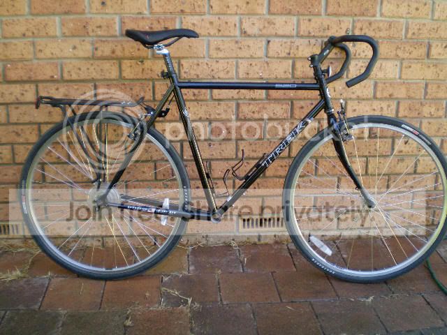

Any problems with that bike on the dirt? Seeing I can't sell my Trek520 frame, I'm thinking of doing the same thing ... and like you, will wind up quite a distance between the headset and the bars.
I'll lose the drop bars of course. The seat is at the right height for road riding so will probably drop for dirt. If I use that neck, with a set of bars that have some rise, the bars shouldn't be too bad. The hubs are DeoreLX. The rims are Bontrager Mavericks which are fairly solid and can be replaced when I finally destroy them. The frame is steel. There's plenty of standover height (the frame is too small for me on the road). It's got V brakes fitted.
MTB drivetrain, mtb bars (with some rise and pull back, I don't like straight), knobbly tyres (with the 29ers now here, tyres shouldn't be a problem and there are hybrid tyres in 700c anyway).
Is it a goer?
Am I nuts?
Where wouldn't I be able to ride this thing (bearing in mind I'm old enough to be here and with four thirds of stuffall mtb experience).
Richard
Is it a goer?
Am I nuts?
Richard

If the bike is on the small side, I would probably go with a dirt drop or moustache bar rather than a flat or riser, making it more of a cyclocross bike than a mountain bike. But a riser would work if you want a very upright position. MTB top tubes are normally longer than road to compensate for the lack of reach with flat bars.
Saddle height can be whatever you choose, but I don't run my MTB seat any lower than my road bike seat.
See how much clearance you have for tires. If 2+ inch 29er tires won't fit, there are plenty of cyclocross tires that will.
Gotta lose the dork disc and the reflectors whatever you do.
