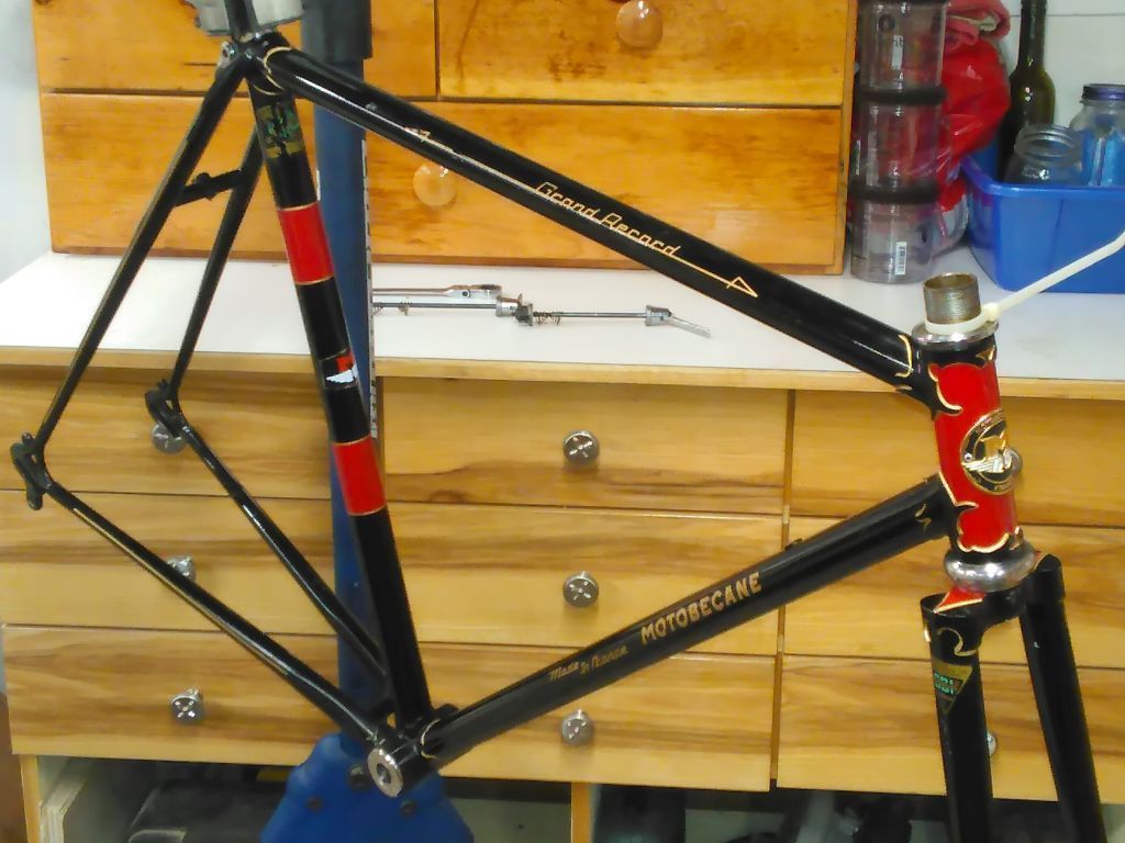

Did you clear cote over the decals or put them on over the clear? Looks really nice, SWIN!!!

This frame was a bit of a practice run for painting; I have agreed to buy a Raleigh Team Pro frame which needs a full repaint, which I'm much more confident I can paint myself now after the Motobecane. Note this is all done with spray cans, but the sandblaster I use also does 2 pack primer as the undercoat so this Moto had a good base to start with. Also, you can now buy 2 pack clear in a can so you're part of the way to a professional job albeit the quality of the color paint and the thickness of the spray! The clear comes out quite thick and hides most of the imperfections though. I wouldn't be doing all this with metallic finishes, but works well with flat colors I think.

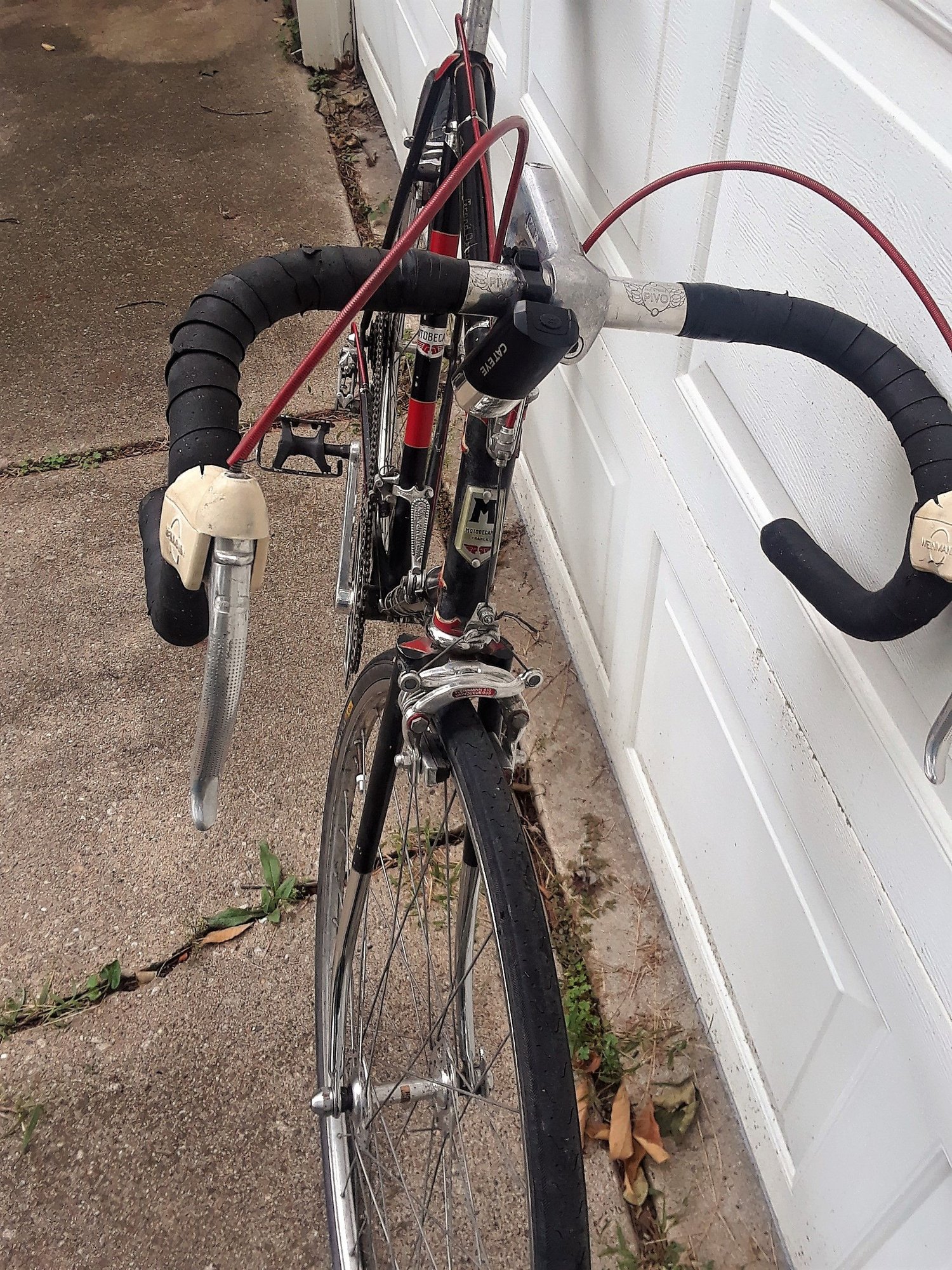

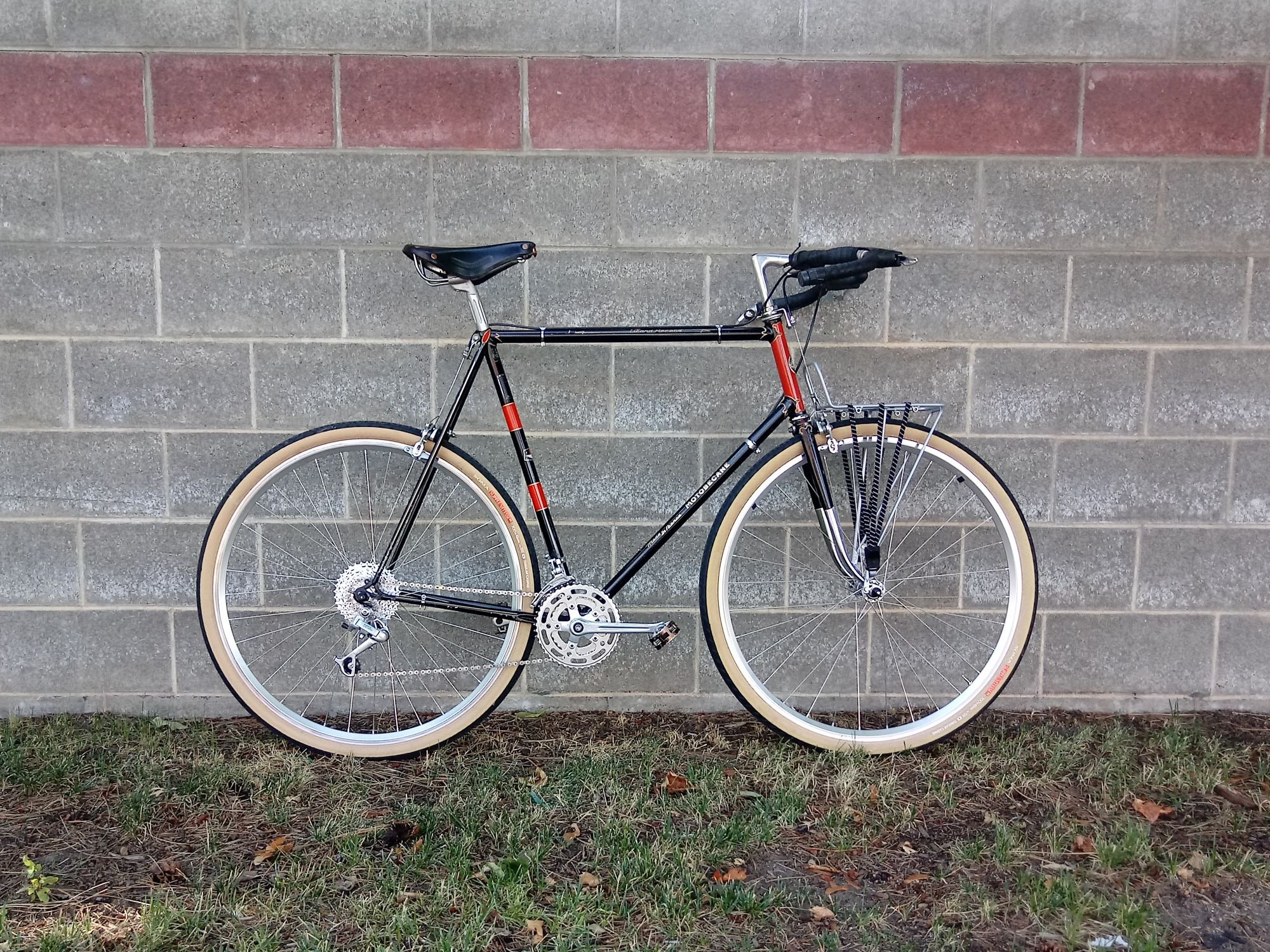

Slowing getting it dialed in. I like to sit up and look around, I've tried drop bars
on this and others but it just doesn't work for me. I also tried the little mini rack
and the bag on the front but it affected the handling too much, this works pretty
well though.

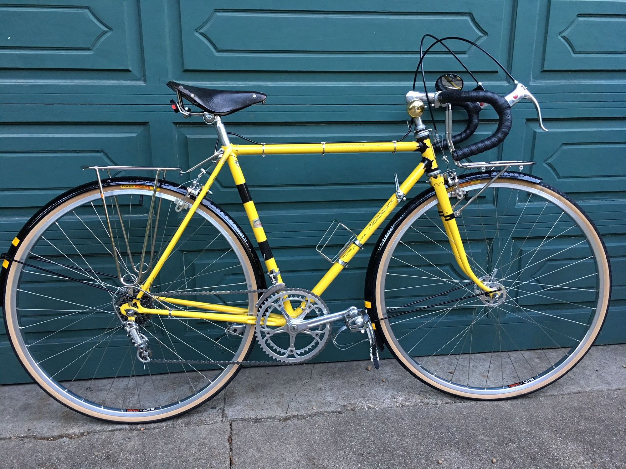

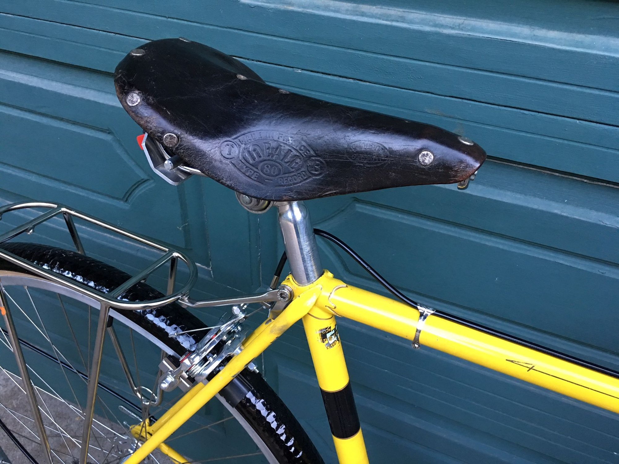

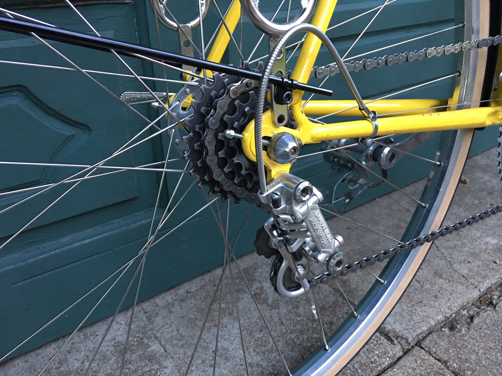

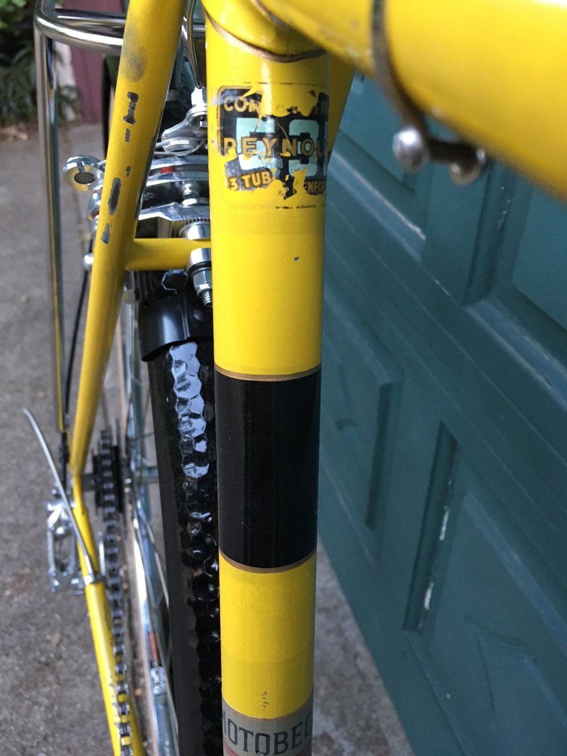

I know this is an old thread, but it’s specific to these bikes so here’s my new-to-me circa 1972 Moto GR:
The frame and fork, along with the Pivo stem and handlebars, Weinmann brakes, Normandy Luxe hubs and other bits are from @Brewsmith. I put it together with the original specs in mind, so it has a Nuovo Record drive train and Atom freewheel. This was my first experience with wheel building and it went smoothly with 27” CR18 rims. The leather handlebar wrap, fenders and racks are from Velo Orange. There’s quite a bit of “beausage”, which I find charming. The Ideal saddle replaces what would have been a Brooks because I had it and it fits my butt. The fit is very nice and the shakedown rides were both smooth and lively. It generates that sunny smile that indicates a new keeper in the house.

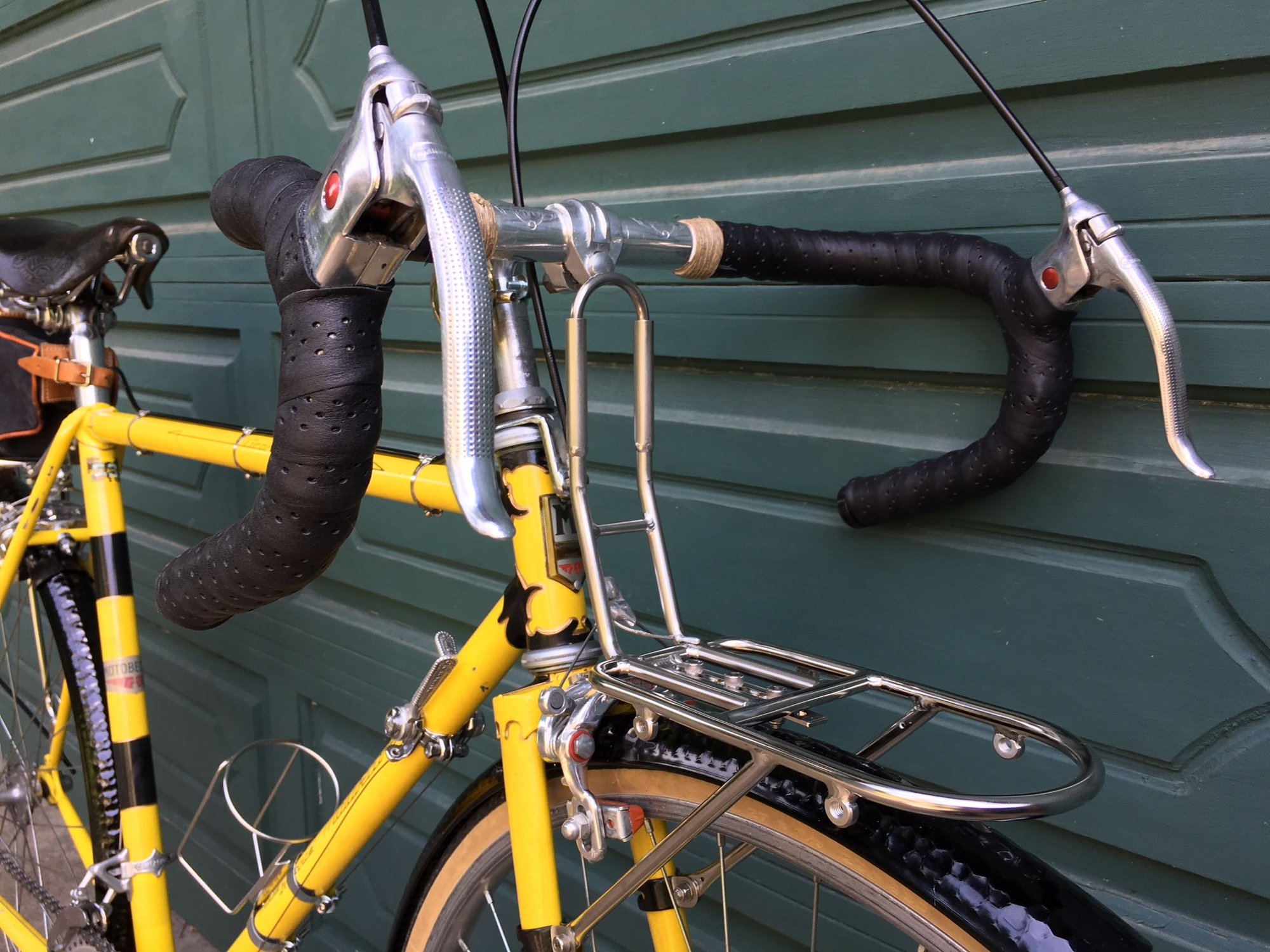

Nice work! Have you by any chance added your serial number to the Motobecane serial number database thread? I think you're right that yours is a '72. I believe they went to full Reynolds 531 tubing in '73.
Can you post of picture of your head tube also showing what's going on with that front rack? I'm curious about the head badge, but the rack is also interesting.

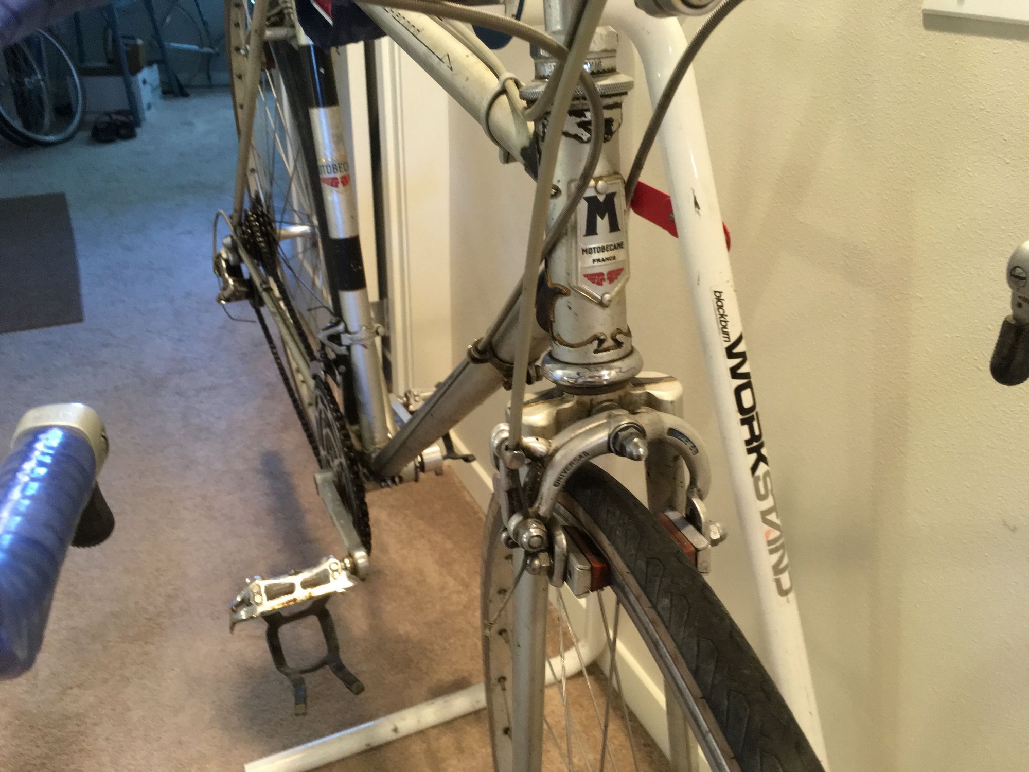

Andy - No, I haven't yet posted the serial number. I'll look tonight and add it to the database.
Here's an oblique shot of the head tube:

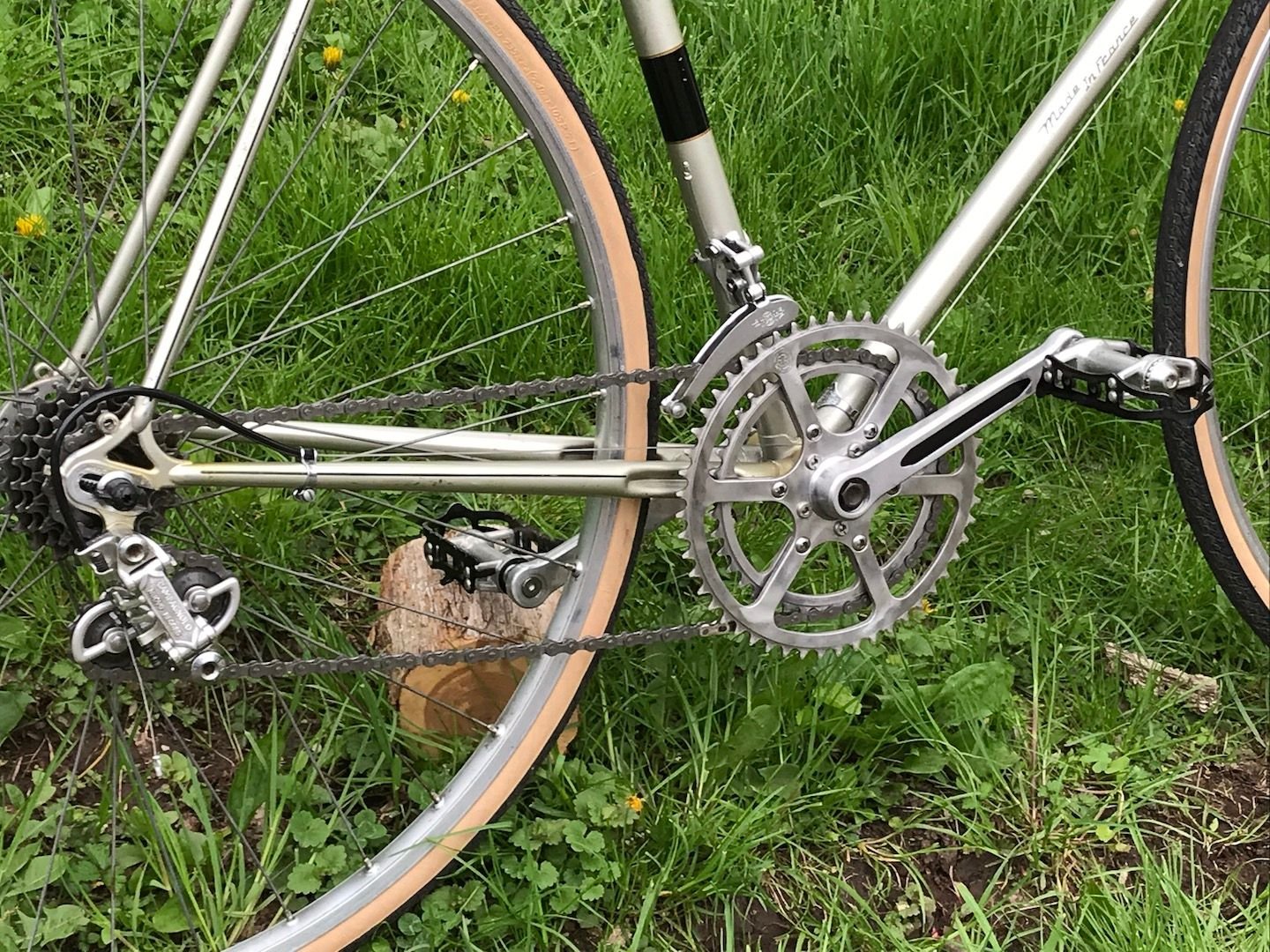

I went a somewhat different direction with my 1972 Grand Record. I bought it from a guy in Portland for $30 in this condition:
Since then it's become a bit of a case study in just how expensive a $30 bike can become.
First it went to Atelier Gugie for some work -- cable stops, shifter bosses, bottle cage bosses, tapping the bottom bracket for a cable guide, and re-spacing the rear dropouts. I stopped short of 650B conversion, re-raking the fork, and front rack mounts. I was young and innocent then (2016).
Then it was off to Forever Powder Coating for a little color.
Only when I added the decals from VeloCals did I realize that I had chosen the exact color scheme of "bacon flavored" candy.
My original inspiration for the colors was a raspberry and crème fraiche desert at a now defunct Hillsboro restaurant. The exact color of beige (RAL 1015) was chosen to match SKS' "latte macchiato" Longboard fenders.
Add some Campagnolo Racing T components (which I also got from @Brewsmith, incidentally), Centaur shifters, Shimano Tiagra/DT Swiss R460 wheels, and a few other bits and I had a complete bike, which cost me...a bit more than $30.

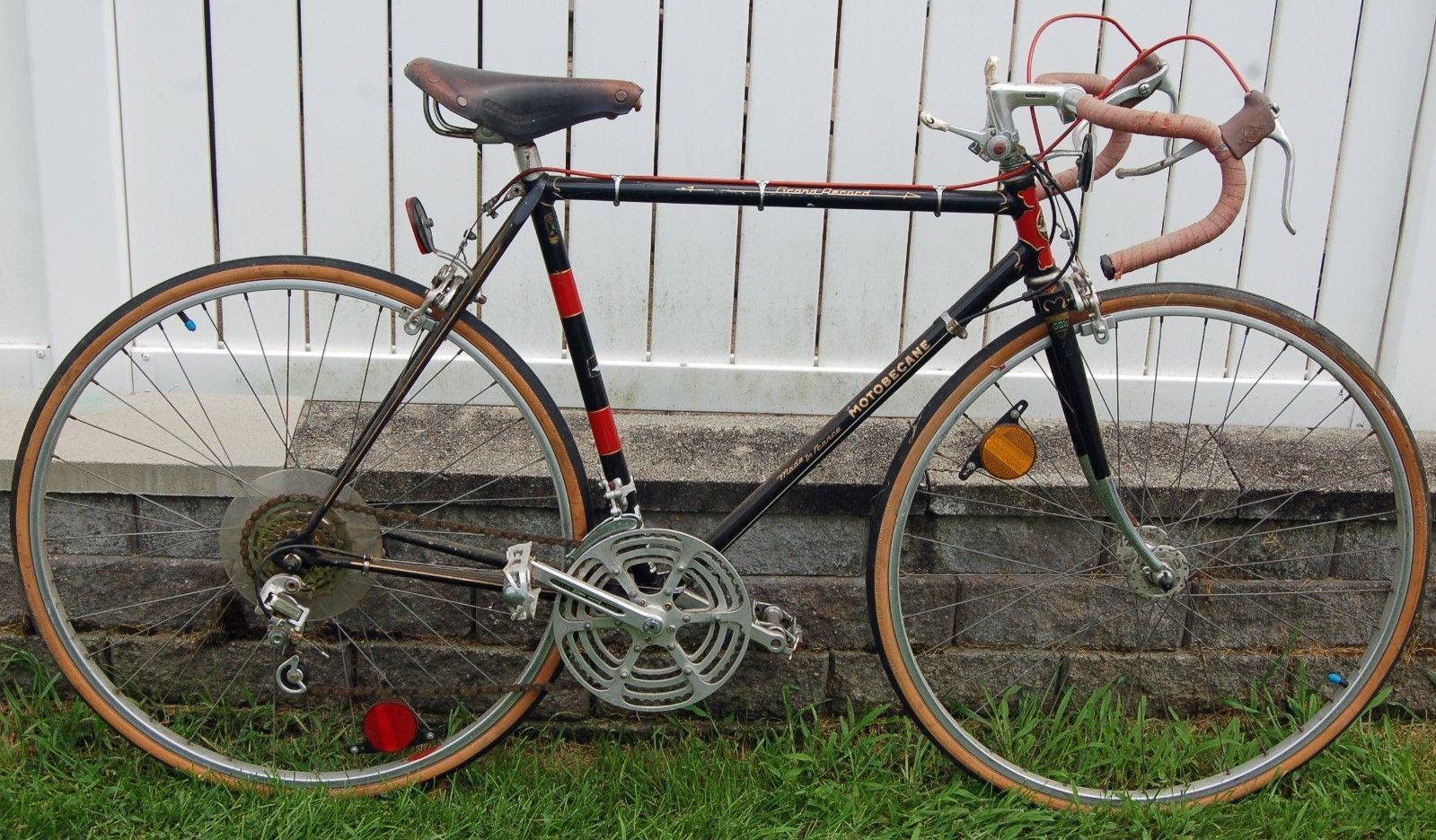

Another GR for restoration
I just picked up this Grand Record from a Craigslist seller in Bremerton, WA. I will likely restore and convert this bike to 650b. In addition to the original stronglight crank and record front derailleur, it came with some nice components include Universal Super 68 brakes, campy pedals, and Suntour bar end shifters.
#140
I just scored another Grand Record, a '75 black w/red panels. That makes 4 in the collection now, in addition to 2 Le Champions, all from '72 to '75. And a '75 Grand Jubile mixte. And a '75 GJ frame. I'm sick.

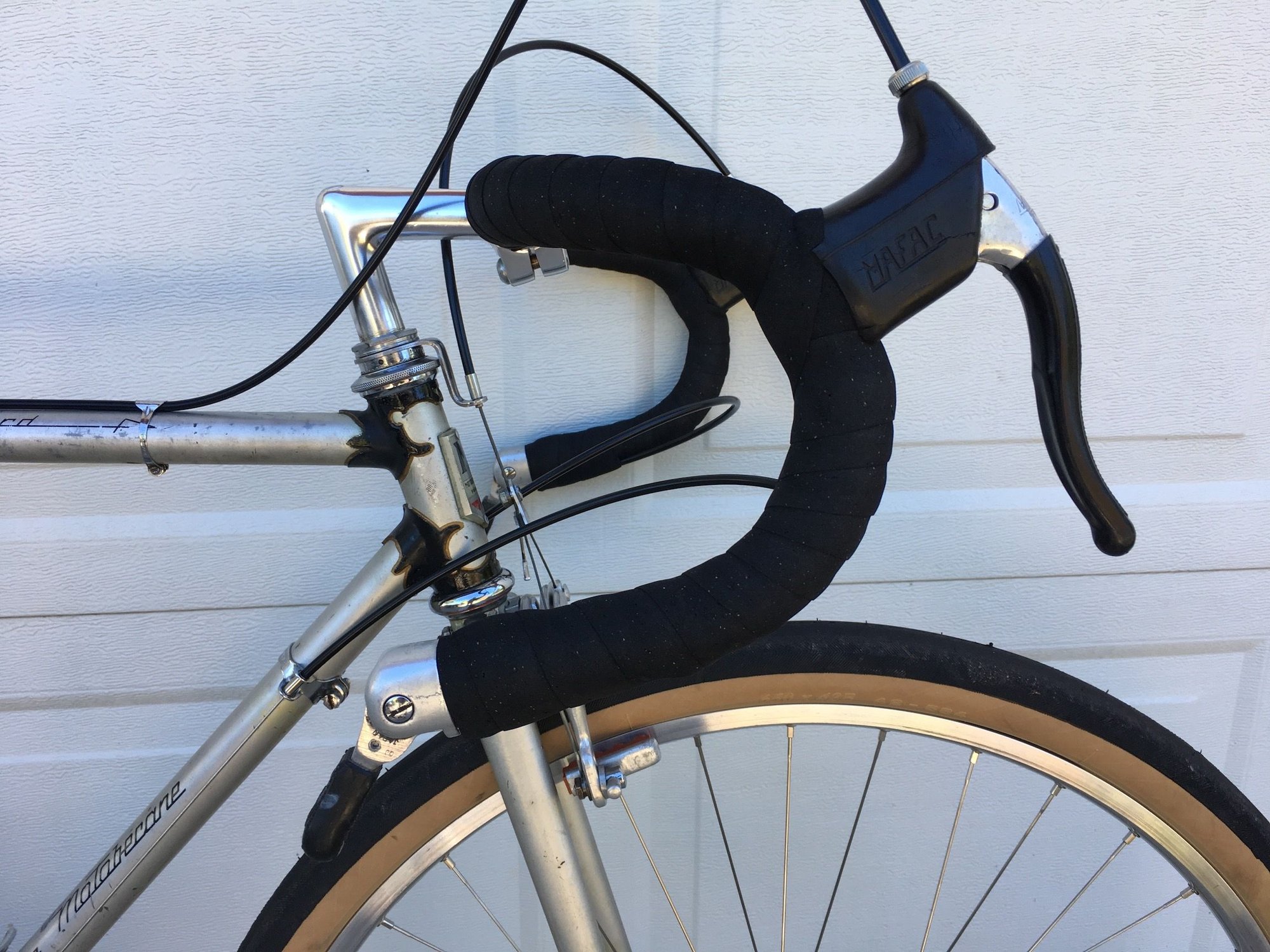

Finally rolling. Still in progress:
Gearing is not figured out yet. Trying to decide between a 2x9 setup or just putting a 17t cog on the rear with a chain tensioner and running it as a 2 speed.
Bartape is temporary. Trying to figure out setup for the mustache bars and whether I will like them long-term.
Needs different pedals. Maybe a basket.
But dang it rides nice. Tires are 700x42 (measures around 41mm) Some Supple Vitesse EX. I had to take some material off of the bottom of the centerpull mounting yoke up front to cram it in there.

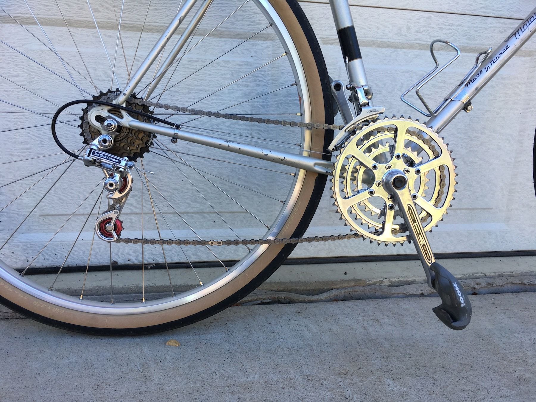

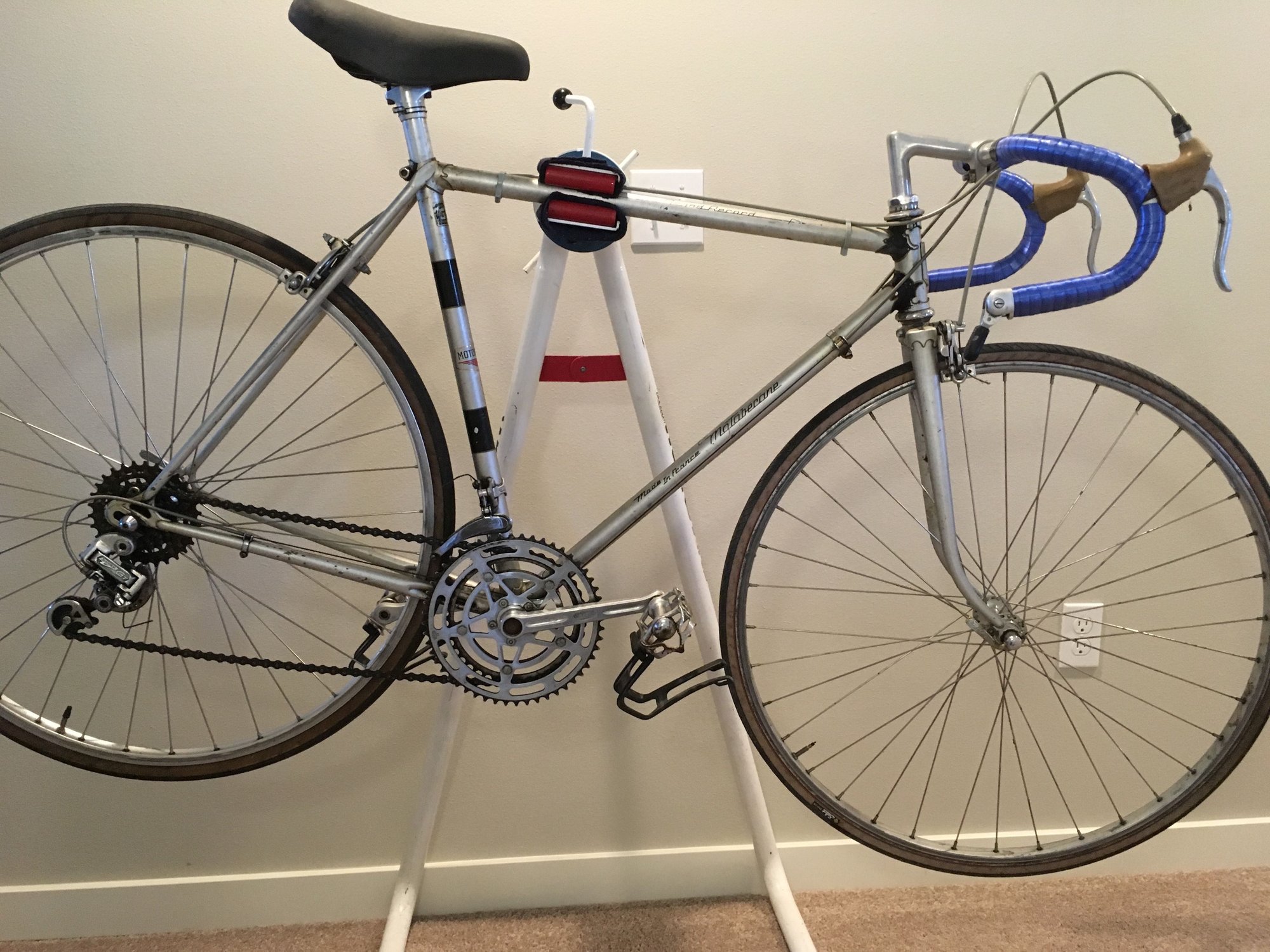

Bought a Grand Record weekend before last and finally was able to pick it up at Fedex yesterday. Pretty sure it's a 1977 model based on frame characteristics and equipment. 77 was unique, I believe.
This is what it looked like in the seller's ad:
Stripped it and cleaned the frame this morning and was very pleased with how it cleans up. I don't know what they used for paint, but it's well done and responds very well to some light buffing with rubbing compound.
Here it is this morning, a work in progress:

It has some nicks in the paint, but overall, I'm very pleased with how it's coming along. The only other French bike I have is a 74 (as I recall) PR10 and this is a far superior bike both because it's 531 all over (PR10 is 3 tube) and construction/finishing. Trying to buff out the white on the Peugeot and it would go through the paint in nothing flat and wouldn't really take a good shine. It's ok, but nothing like the Moto. It buffs out as if it's lacquer, but more likely it's chemically hardened and baked enamel, but that's a guess.
In the seller's photos there were marks along the top tube that looked like it had been scratched, but to my pleasant surprise, turned out to be some light colored paint transfer from something it had been rubbed against.Careful hand buffing to avoid the gold logo, and the offending stains came off pretty easily.
I'm really impressed with this thing -- great bikes.

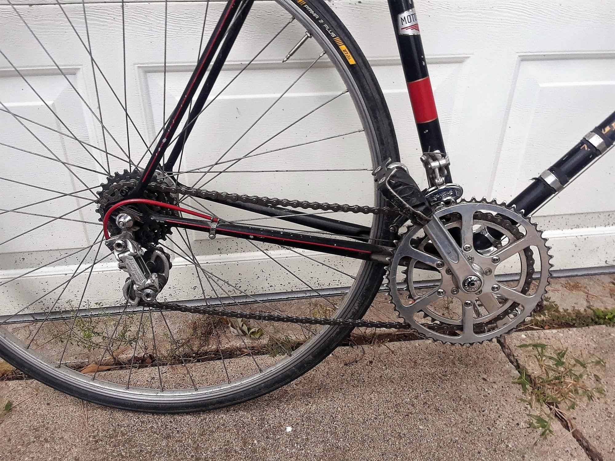

1973 Grand Record
This is the Grand Record that has been my winter project. Just finished it, did the 30 mile test ride and gave it back to its owner. I sure enjoyed this one. This is just my size too BUT not sufficiently different from my Raleigh Pro to dream about owning one of these. Perfect for me - a real nice winter project without needing to find the space to keep it.
Frame code is 64316A (1973) and the RD is Pat 71. That's why I'm saying a 1973 model though color catalogs for 73 and 74 seem to be pretty rare. Verified head badge photos for those years are rare too.
This was an actual barn find. Coated with decades of dirt, grime and mud dauber wasp nests. Rear wheel went missing long ago (but I had one that noglider gave me which suited perfectly). Its hard to tell how much is original but I suspect the Campgnolo drivetrain, Weinnman center pulls, Pivo stem and bars, the Brooks saddle and the front wheel are original. As you can see the paint came out just lovely. Several new bits and it's a great ride. The test ride was on Philadelphia's Schuylkill River Trail yesterday. Tail wind heading out and headwind heading back but otherwise a lovely spring day. The paint looks great in the sun.
The current owner will be selling this bike. If I find where (eBay, Steel is Real, etc) I'll post it in the "are you looking for one of these" thread.
