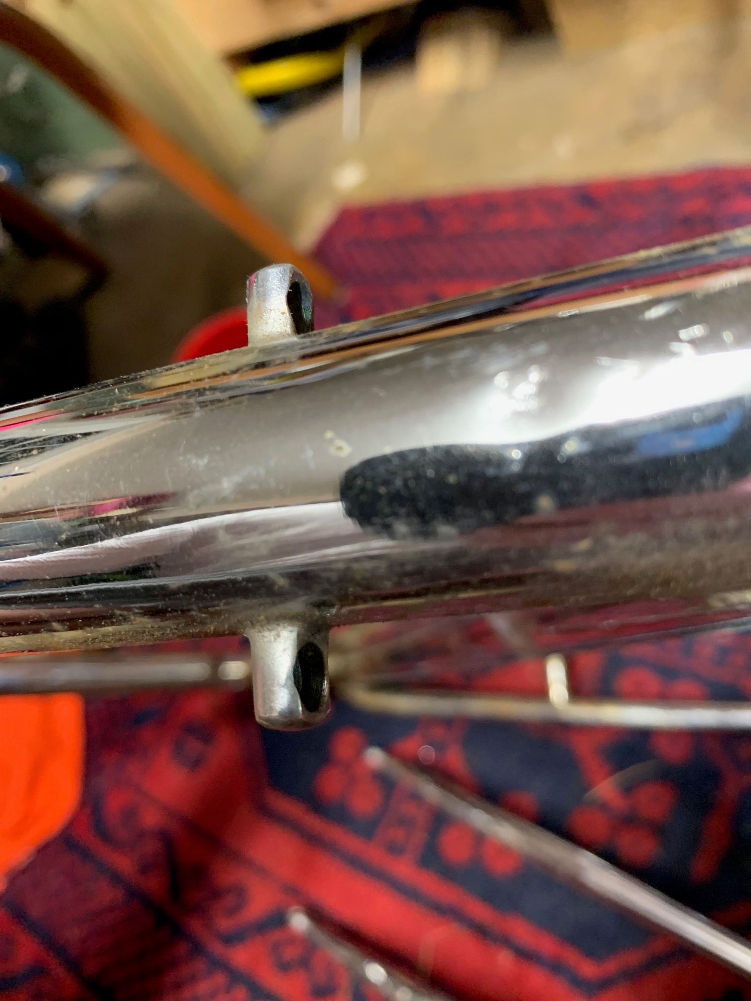

If the serial is anything to go by, potentially a more mass-marketed frame than we might think. #385 of 1969, perhaps?
That assumes, of course, that the fork and rear bridge were drilled. Do the recessed mounts look factory? If so, perhaps we're dealing with a newer bike than my mind would like to think it is.
Wearing myself out checking chainstays at Classic Lightweights...
-Kurt
-Kurt

Cable guides like those have been on some bikes posted in this forum recently. Older ones. I have a 72 Lejeune that has them. My 72 Crescent does not have them. It does have the lugs. Crescent made a chrome bike. That is one possibility.

The cable-guide braze-ons on down tube were fairly commonplace for any bike intended to use bar-end controls (barcons) so nothing that unusual on a frame with long DOs and cable clips, etc. Does sort of indicate this may have been a semi-custom build for a customer that specified what components they were using. Many Brit builders would do that including Holdsworthy (who also very occasionally did use Nervex pro lugs but AFAIK not an EDA BB shell). This may never get an exact ID but OP could try sending it to somebody like Norris Lockley or Hillary Stone...maybe best to join and enquire thru the Classic Rendezvous "List" (a Google group, free to join) Also agreed that having recessed bolts for both F&R brakes IS a bit unusual for a frame that appears to early for thi, BUT let's see a pic of that brake bridge (and the 2 may have been drilled out after-market or it's more evidence of a "custom build")

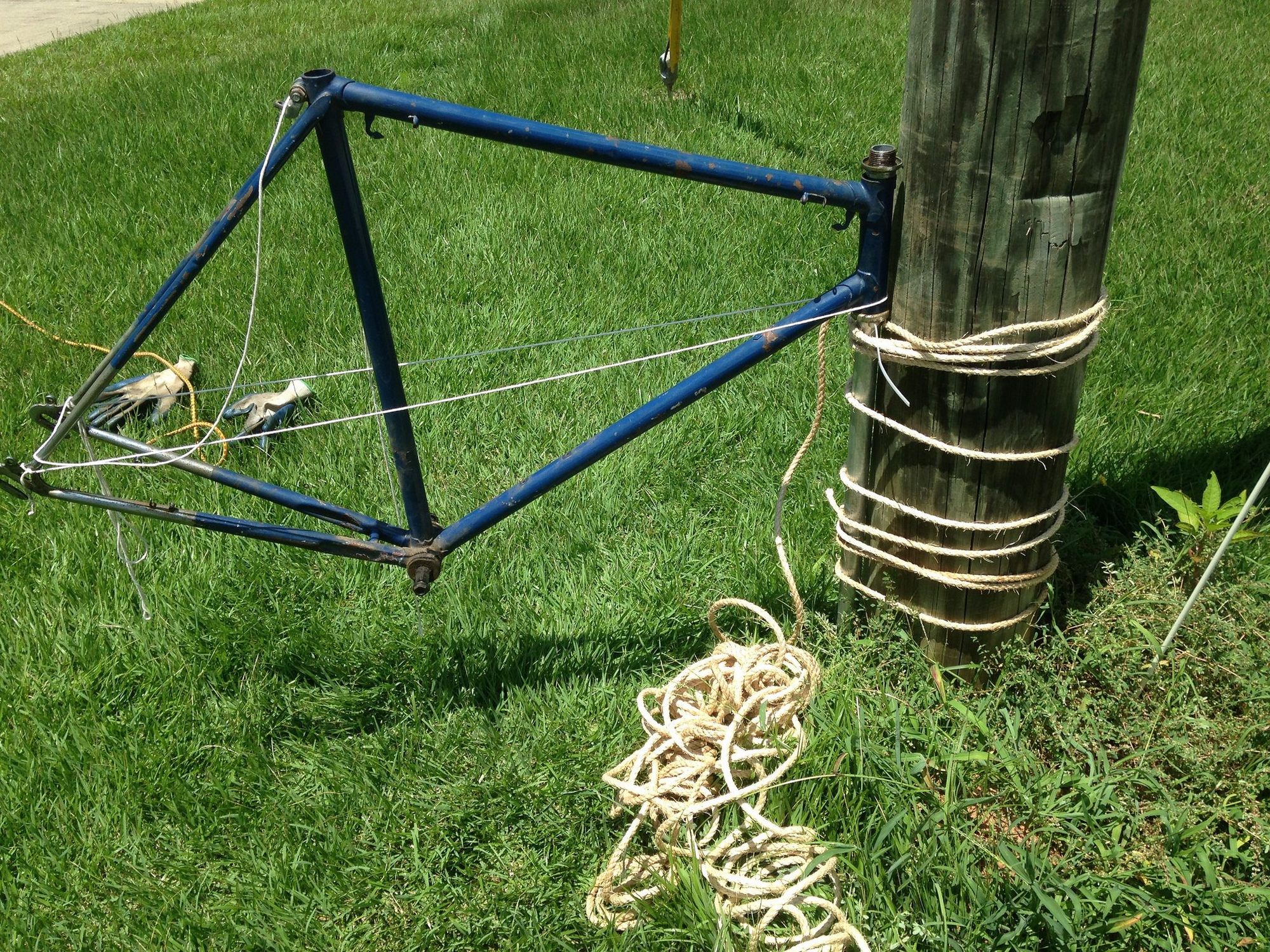

Thanks for info. Yeah...about the rust issue. Bottom bracket area is bad. Now I need to investigate, among the products that can be used for rust removal , which will not damage the chrome patina. If you have any ideas, please share.

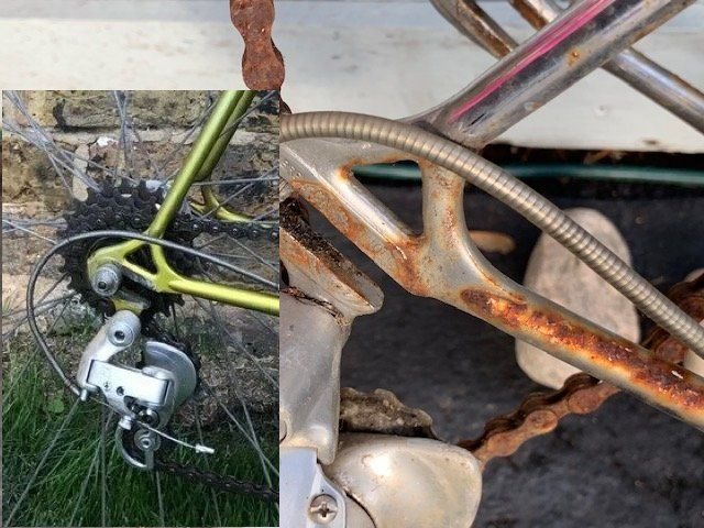

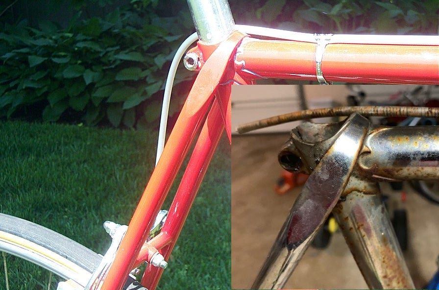

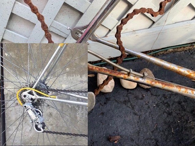

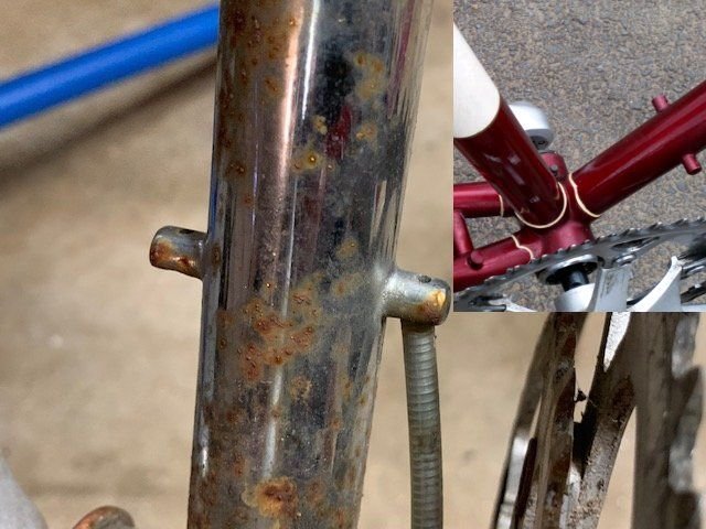

Most of the elements of this frame were employed by multiple British marques, so pinning this one down might be difficult.
I don’t have an exact match for this mystery bike, but here are pics of individual elements found on various frames, all from the same marque (I’m trying something new with the pics, so bear with me):
Nervex Pro lugs, “rib” (or rim/lip) removed:
Sloping fork crown:
Double chainstay cable stops:
Double cable brazeons on the downtube:
Brake bridge:
Wraparound seat stays:
Stay ends:

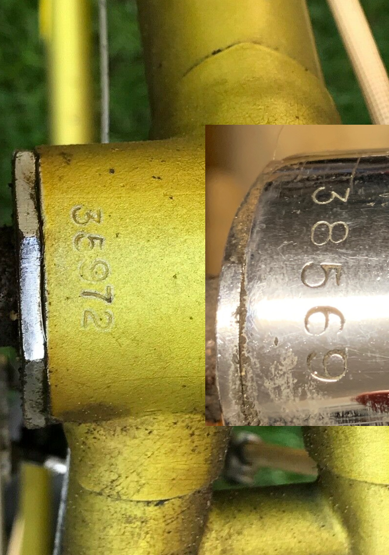

5 digit serial number on bottom bracket shell, stamped parallel with the drive side edge:
All the compare pics above are from Mercian built frames.
As I mentioned at the beginning, I don’t have an exact match, so all this doesn’t necessarily mean we’re looking at a Mercian here, but there are enough similarities here to warrant further investigation.
You will find Mercians with:
“RVM” stamp: I have no clue what it signifies; never seen one like it. As @unworthy1 mentioned earlier, it looks like it was probably stamped later as it looks more rusted out than the frame number. This would point to it perhaps being PO’s initials.
EDA bottom bracket shell: Use of EDA bottom bracket shells by Mercian is an unknown here that might throw a wrench into the spokes. I’m not a Mercian expert, so if anyone knows more about this, please share the knowledge.
Serial number: If a Mercian, it would point to the frame being made in 1969.
Luckily Mercian is still in business and active online, so you might be able to get a confirmation one way or the other. Would love to hear what their official response is.
As always, this assessment could be way off and we might be dealing with something completely different, but for the moment I’m leaning towards Mercian.

- Double downtube brazeons as on the mystery frame
- Double cable stops on the chainstay, as on the mystery frame

- 5 digit frame number on the bottom bracket shell, stamped along the drive side edge

Now that @MauriceMoss has posted those excellent pictures, I'm rather more convinced than he is that we are looking at one.
I dare say the identical treatment (and spacing) of the derailer cable stop is enough of a smoking gun on its own. Combined with the double cable stops alone (as opposed to a clamp-on fitting) and it's difficult to say otherwise. The treatment of the wraparound stays is also dead-on identical, and while other builders may have achieved similar results, achieving identical results is another matter.
-Kurt

Yes! I think this is closer than ever to the solution, thanks to PROFESSOR Moss, again! If somebody can confirm that Mercian used EDA BB shells I'd say Moss has nailed it...bravo!
