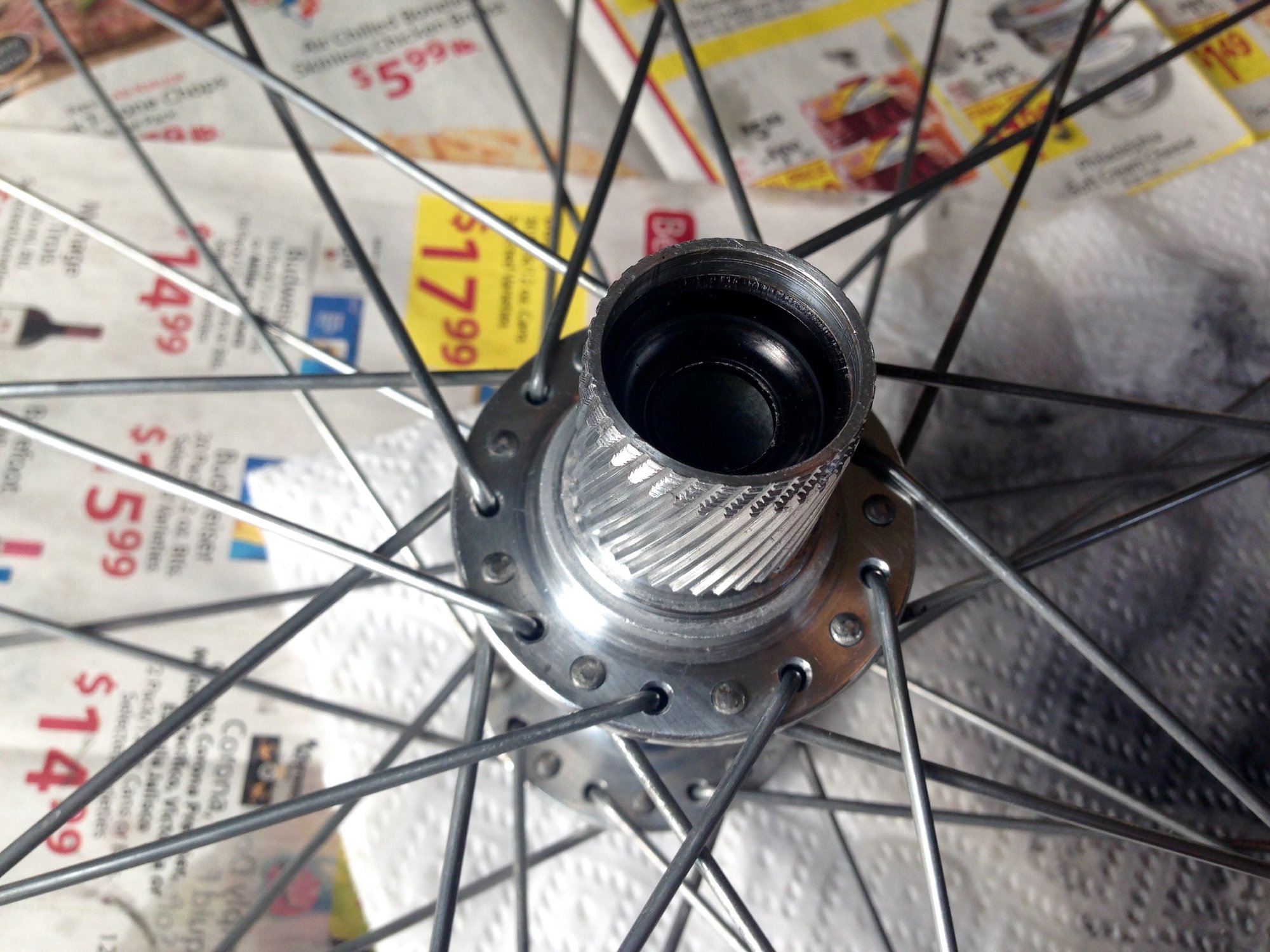

Here is the rear hub all cleaned up and repacked. I didn't take the sprockets off the freewheel. I just sprayed it out thoroughly with WD40, spun it until everything was clean, then dripped some light oil in.
It's working perfect, although it did before also. The wheel does spin longer now, and interestingly the freewheel is silent now.

I wrapped a couple rubber bands around the lock ring and gently used channel locks to remove it. It came off super easy.

That's a good looking job; nothing beats riding a bike you've fixed up right.
