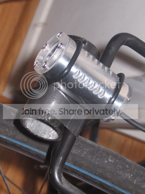

So here is one where I took a piece of cut seatpost and just duct-taped it to my rack:

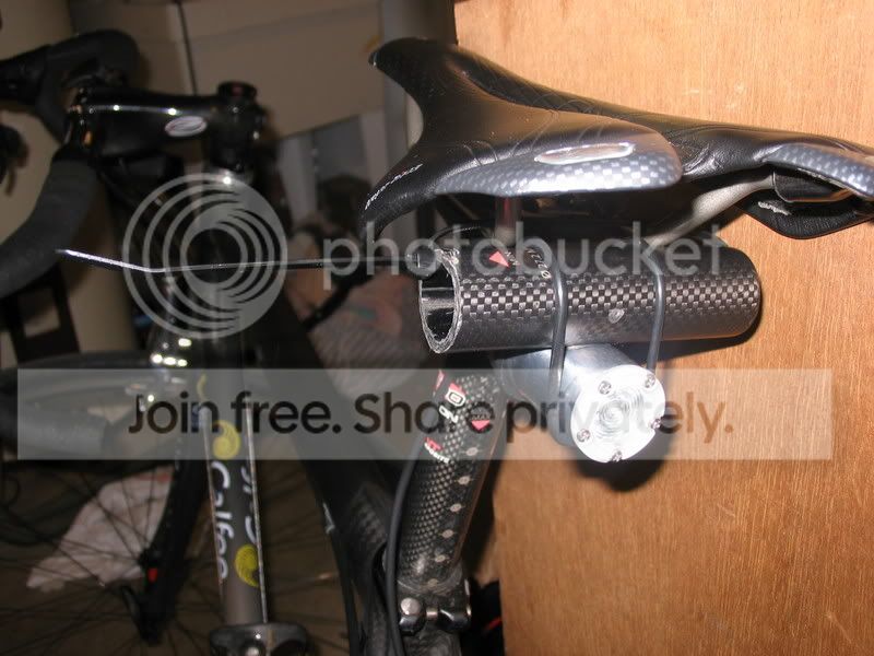

And this is one for tibikefor2 because he wants a way to mount it on the cross bike:
There are a couple of ways to rig it. The thing is you need a fore aft not just a horizontal anchor or it will slide around. For a seat like mine with a cut-out, you can just drill once all the way through the tube (PVC works as well as chopped carbon fiber, and you can always color it black with a magic marker) and loop around a long zip tie to snug it up. Or you can drill two off-center holes and wrap it all the way around the post itself. In this case you will want to cut it slimmer than as shown and then it will wedge between the rails.
Of course, this takes away your ability to carry a seatbag, but I don't need that anyway. I just keep my tools in a plastic envelope in my bag, and as I use different bags, that makes it simple to swap things around. If I go for a weekend ride they can go in a jersey pocket or the seatbag.

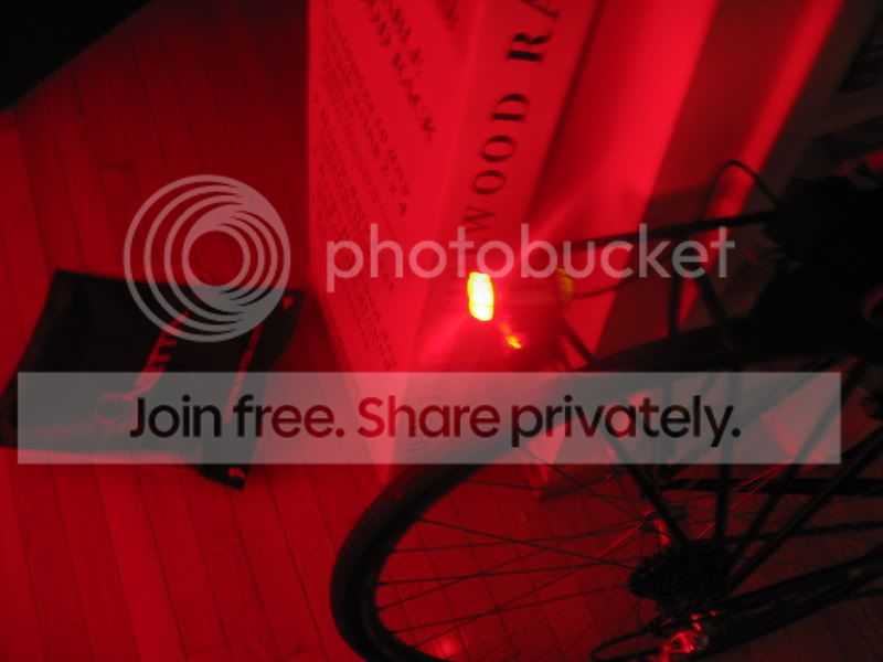

Hey flythebike, could you put the light about 4 meters from a white wall and take a no-flash photo of the beam pattern on the wall, and post it?
The bike and I are 4 meters from the wall. Those curtains measure slightly wider than 2 meters so the spread is about 2.5-3 meters.

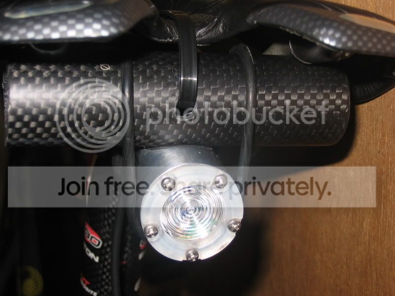

Also, I fiddle-faddled a bit and ended up with this:
The only trick is that you have to mount the o-ring "permanently". You have to put it in place and then tie the zip tie or it goes on crooked. But this way you just need the one zip tie and it is snuged under the seat, doesn't move and won't hit your thighs.
Very nice! So perfect aim isn't 100% necessary
