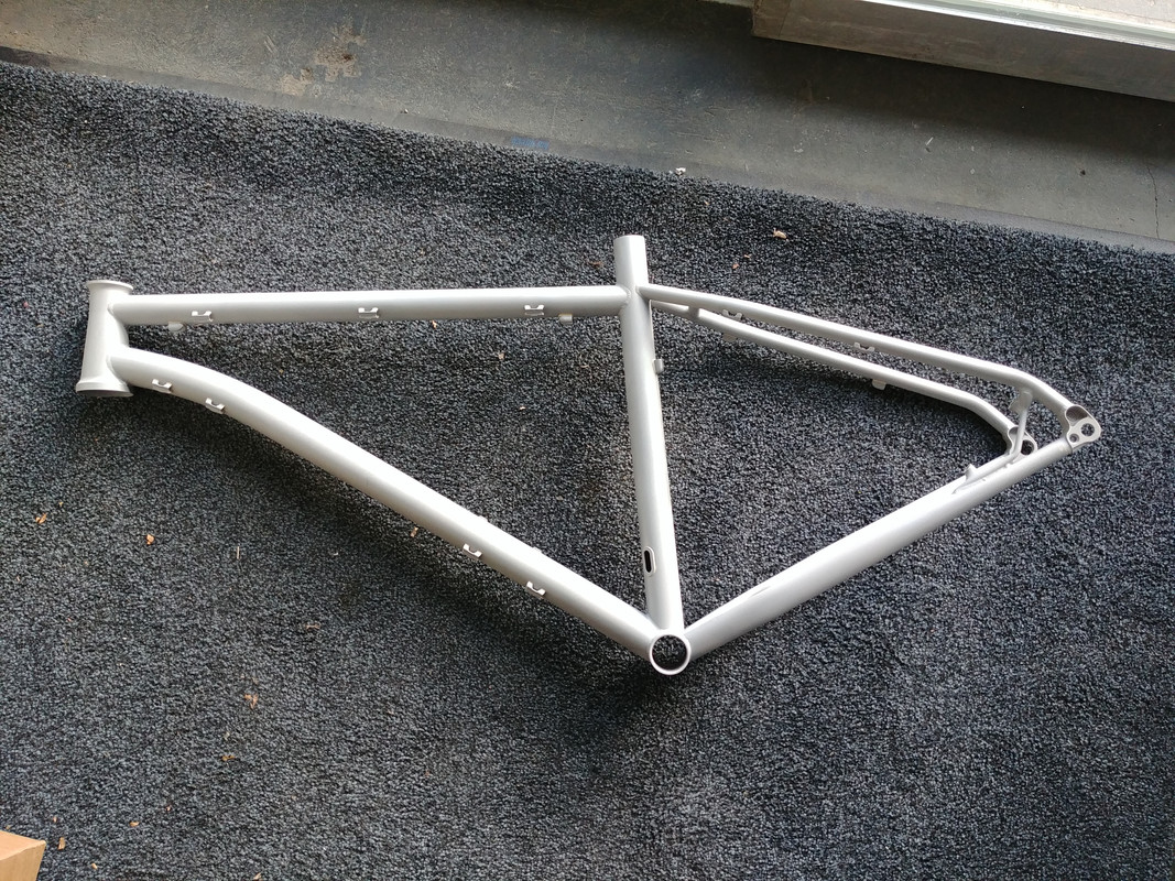

Today the frame and rims went from stripping directly to the polishing and chroming company, Walt AG in Fällanden. They were very professional and the guy knows his stuff, but the price was admittedly steeper than my last build which required nearly exactly the same amount of polishing and chroming. End results will be ready to pick up in 4 weeks.
That grit on the frame is residue and not the steel.

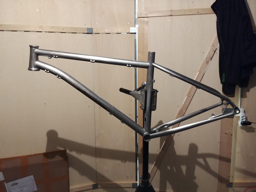

Had some time for the frame today:
Bare steel:
Close up:
Buffing material:
After one simple buff, I realized that I probably should start sanding:
After some scotch pads and another buff, I then knew that I had to start sanding!
I've got my work cut out for me. Lesson learned: chemically remove paint from steel frames. 2 weeks to go and I have plenty of sandpaper... Not particularly looking forward to all the handwork. Most of all I regret having the paint removed by sand-blasting. Now I've got to remove some of this steel to achieve a smooth surface.

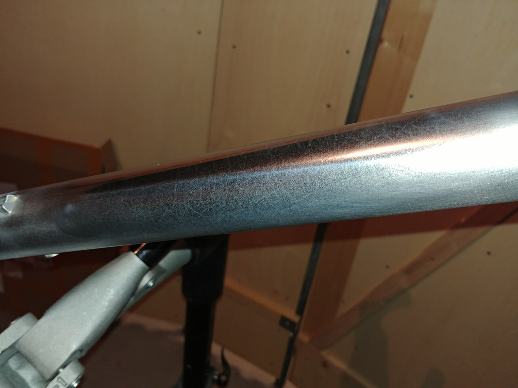

Worked some more on the frame today with primarily 120 grit sandpaper. If you ask me, that's pretty coarse. It looks however that I need to go even lower if I want to get the job done this decade.
Here is a good shot of an interesting effect left over from the defective paint job:
Starting to shine a little:
The 120 grit is not working so well. Even after quite a bit of time, the blasting can still be easily seen:

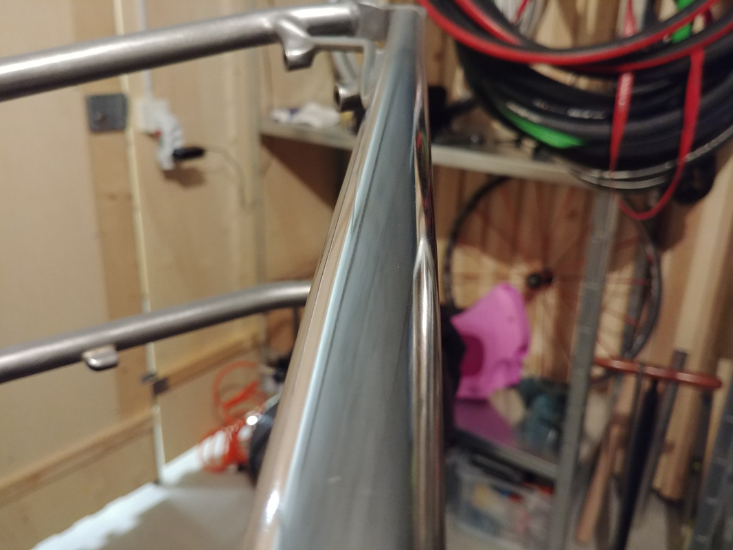

So I have only to polish the rear triangle and some touching up in other places. The buffing is going well but it is indeed tiresome.
