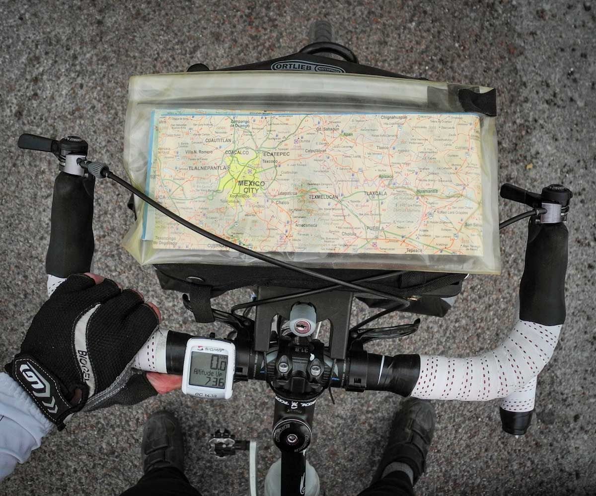

Oh, also about the gevenalle units.
Mine is a 9 speed one with cable pull for mountain bike mechanical disc brakes, BB7, and as with all of their various versions, 9,10,11, there is a little rotating part that switches from index to friction.
But honestly, indexing just works. Like the last guy described, if everything is in order, it's flawless. My 1990 or 91 dt 7 speed tourer has shifted perfectly other than a handful of times when a slight barrel adjuster turn was needed a few times, other than that perfect shifts every time, up until today when I ride it on my trainer.
I also find the gevenalle units to be actual pleasant to use. Part of riding is, for me, a physical enjoyment of how stuff feels, shifting etc, and I like how they feel.
Handy like brifters, but with a physicallity of moving your fingers in different positions to shift that I like.
I bought them to set up a tough touring bike for some Latin America trip, and have spent months on that bike, a third to a half of Mexico, through central America, across France, and millions of shifts, and I like it still and enjoyed the physical shifting.
So that's my positive report on them, AND I think they look damn cool and different. A cool mix of old and new.
The company used to be called Retroshift, but I figure they realized the retro wasn't good for younger folks, so changed the name.
