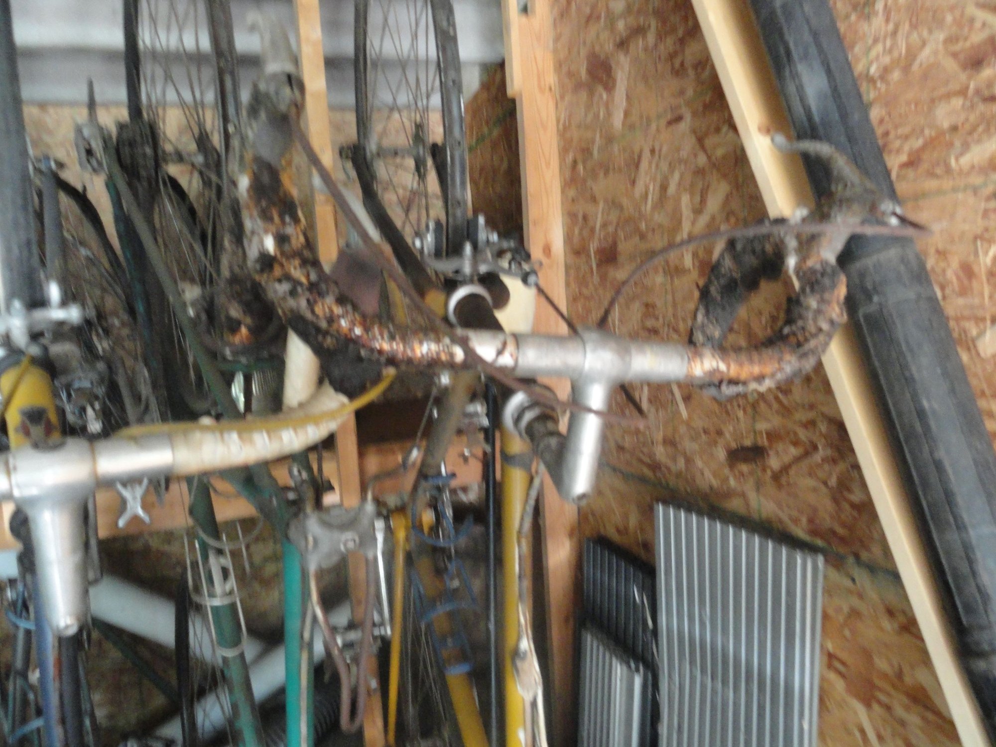

pdlamb,
I doubt you will regret it but I really am not much for hanging out in the woods around campfires with the likes of Smokey the Bear and Yogi Bear. But it did make me chuckle! I am attaching a couple of pics of three of the un-restored bikes that were caught in a house fire. Everyone suspected arson but the Fire Inspector could not say conclusively.
