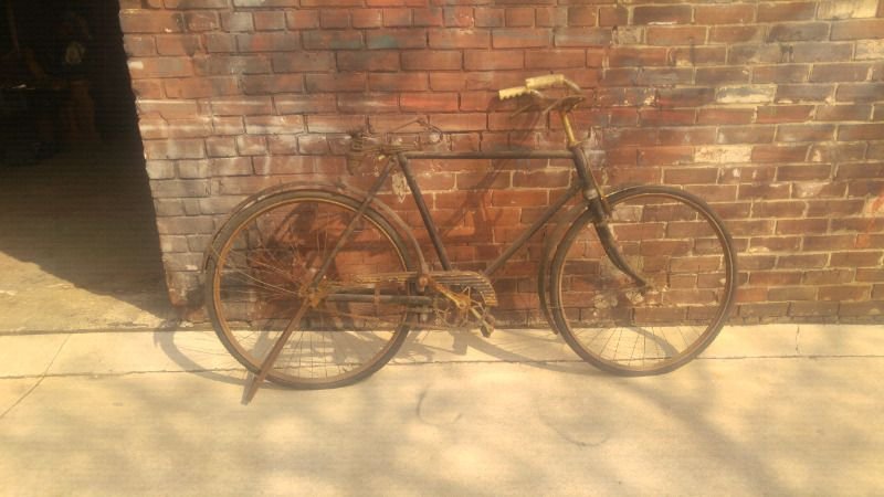

Originally Posted by BigChief
I like the looks of this one. Wish I could see more. The mudguards look pre war to me.I even like the funky art deco chainguard. Old aftermarket or off an American bike? I think I'd keep it.
I've contacted the owner so may go and have a look tomorrow.
I'm wondering if it might be an Indian built Hercules....
I see no evidence of a 3 speed cable.
Is the kick stand British?
Those shallow mudguards are from the 1930s. From the catalogs, Herc mostly used the "HERCULES" or a simple spoke style chainring similar to the Raleigh, but this style does appear on the juvenile models, so it's not far fetched to assume it could have been also used on full sized roadsters at times. 3 speed hubs were an option back then. Also, back then, these roadsters either came with the enclosed chainguard or no chainguard, so this later addition helps point to a pre war date. I'm thinking this is a pre war Herc.
Good to know.
Good to know.
Going to have a look tomorrow am
I think it's worth a look. I can't see much from this photo but I do see those early mudguards, bolt on stays, cottered crank and Hercules style fork crown cap.

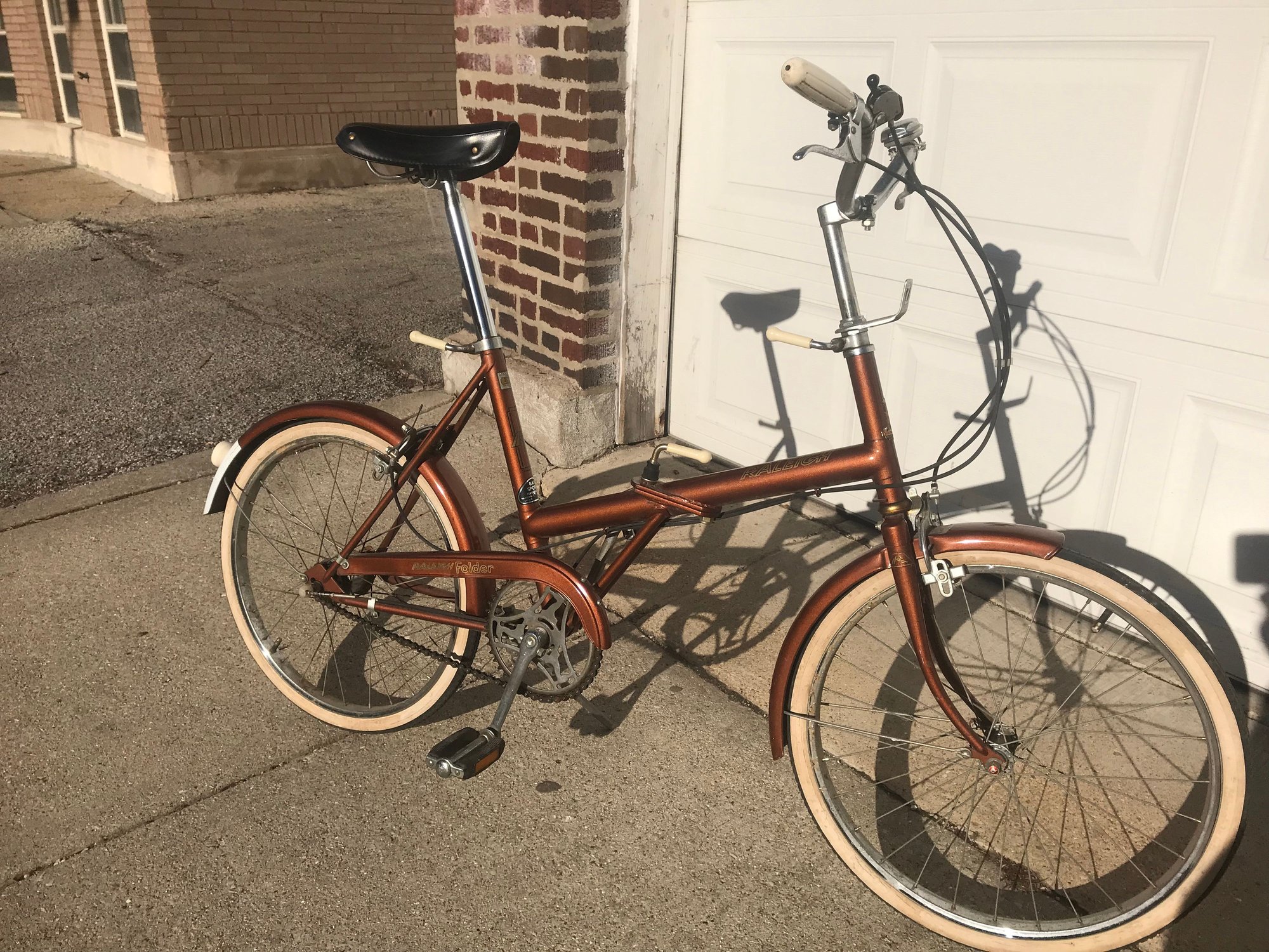

Originally Posted by 3speedslow
@Chr0m0ly
What are your plans for that wonderful folder?
Free up the gear hub! She's stuck in gear... 2? I think?
Then ride it!!
But of course there's a plan...
Swap out as much steel for aluminum and drop some weight!
Put on a Brooks B66, to put some weight back on!
So aluminum wheelset, seat post, bar stem, and maybe mustache bars.
I'd like to put on a cotterless crank, using a new axle but keeping the hub.
I need to source a rack ASAP.
I love the matched fenders and chain guard, so they are staying, despite the added poundage.
I want to put the fattest cream colored tires that I can fit.
Any input or critique is welcome!

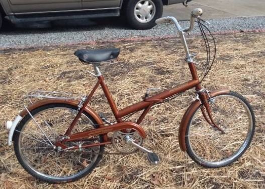

Then ride it!!
All in, a good plan. A little further then I will be going but, I concur wholehearted with the rim change and saddle choice. I travel(ugh) 4 hrs round trip to get mine tomorrow! Can’t wait to see some more pics of the future changes for yours.
Mine is Canadian of unknown year. Appears to be in great shape. Like you I will be going over it then riding it! The Twenty and the Schorcher should get me through the SOTS Challenges well.
mine from sellers pic
Glad you found one, and Canadian to boot!. Is that the coffee colour? I've put 20" Schwalbe Marathons on both of our folders with good success.

[MENTION=298130]browngw[/MENTION]
im not sure of the tires but they are brand new and tubes. He had it recently done. I’ll have to report back on their make. One thing I did which impressed him was to make sure the front wheel was installed correctly. He checked, it was. He said it showed the bike is going to a good home.
Yes, coffee colour. My favorite!

Man, besides pedals and those cool rubber covers on the clamp arms, ours could be twins.
i sure wish tomorrow was already in motion!
I see that Kalloy makes a good long seatpost, who are you going to use for the rims?

Needing a bit of help from the experts. I am going to be in contact with someone with a Raleigh Royal Roadster. I haven’t talked to him yet, but from the limited info I have it was purchased in Europe or England and is in “beautiful” shape.
My limited research would point me to the later version that I have seen pictured that was made in the late 70s. I couldn’t believe it would be a great survivor from the 50s. Is that late 70s version desirable? They look nice in picks with all the extras.
it has the rod brakes, enclosed chain, pump, basket, rack, new tires. What is a fair price for a nice one? $250-$300 maybe.
