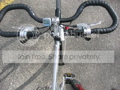

I've put in 20 miles on the trekking bars I just converted to, and I love them:

Did you wrap them with foam?

I see everyone is putting the controls on the near side. Wouldn't that drastically change the reach? Why not put them out on the front?

Ranger, I have mine on the inside, very comfortable. I tried the front, but it did not feel right. It may work great for you though. I got an email ad from Nashbar and saw these bars on sale at $9.99, killer deal.
Well one reason for putting the controls on the near side is ease of fitting. Thats where there designed to go and I certainly wouldn't want to struggle to get them that far onto the bar. Flat bar controls unlike road bike brifters have solid/thick clamps that aren't designed to slide around curves. Anyway I want the controls in the closer position so I can get my weight further back for braking/decents.
Reach is adjustable anyway with different stems. If you leave your current stem on then one side is closer and one side is further away. You can however fit a longer stem so the closer bar is now where the flat bar used to be and the other bar is further infront. You can set the front bar higher of course. Its all up to your preferences.
Consider flipping the bars around so the controllers are in the front and the curved end is closer to you.
