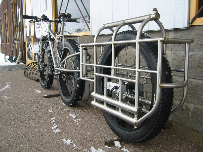

Once it is welded as shown, I am going to cut out a ~10cm section from the middle of each of the short ends (and the cross braces), then shift the resulting two long halves back together, thus making the whole thing about 40-45cm wide. This is so that it will be no wider than my handlebars. I have drop handlebars on my bike, and they're fairly narrow. The frame as it is now is already narrower than handlebars on many hybrid/commuter bikes, but I want to be able to go exactly where I could go before, on my current bike (since I don't know when I'll be employing new bikes or anything).
Plus, a single-wheel trailer needs to be pretty narrow, I imagine, for stability.
Seeing this lovely big trailer frame is tempting me to make a two-wheeler instead, though. The one-wheeler will be such trouble to get right!

Before you start welding. A little tip! Get a length of wooden dowel rod (cut it to size) and slip a couple of inches of it into the basket tubing - (you could glue it as well?) then slot it all together. This will reinforce your tubing at the weld points plus make your basket SOLID and easier to weld.

Wow, how about this mono trailer I just found.
Guys blog.
https://lacemine29.blogspot.com/2008/...-timeline.html
